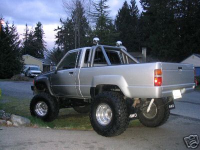

I'd like to install a kill switch on my 86 toyota 4x4. I'd like to wire it up, where the switch is wired into and exsisting switch in the car. For example: honking the horn before the car will start or Push cig lighter before car will start ect. Any thing that can't be located easy. Is it possible and/or safe? If not, I'd like to know how to wire in a "push button" or "flip" type switch Upload
