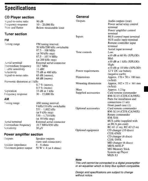

this is a pic of the hu specs. point out the gain if you will please.

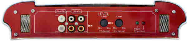

as for the amp gain, would it be the 'level' knob in this pic? it has min and max as its settings

From looking at the HU's spec, it doesn't list the pre-out voltage. So then you can assume it's 4v.
On the amp lot of them will say "gain", however, on your pic, I see one that says level and the other one is too blurry to see. Look at the min V number and the max v number. Try and find 4v setting. Where is the setting at right now on the Level? Just curious.

the two knobs are both level knobs. one is for 1,2 chanel and the other is 3,4
i wrote the 'level, 'min' and 'max' because it was too blurry.
i had it set at around the 10 o'clock mark i think. there are no V numbers whatsoever on the amp or its instructions.

Really, then that's a sh**ty manual. They have to tell you what the min and max voltage is. Without that, there's no way you can match the HU's output voltage.
That is weird. Even my old amp had the voltage listing for the level/gain control.
From my older amps, the ones that don't say anything on the amp, they're usually 4v. So min = 4v and max = .5v. With that setting, if you had it at 10 oclock setting, it would killed your amp slowly. Most amps can only take so much with incorrect gain setting before it dies.

Ok keep this tip in mind for the future. Whenever an amp doesnot list the v in the setting, start off with the min. First turn up the HU's volume till you hear distortion. Then turn down a notch till it's gone. Now turn the gain/level slowly on the amp till you hear distortion. As soon as you hear that, turn it back down towards the min till you hear clean sound. That is the setting it should be at.
