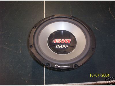

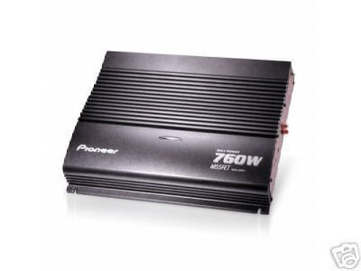

Is it okay if amp is getting so hot that i can touch it no longer than 3 seconds? Thats Pioneer GM-X862 2-Channel 760 Watts Car Amp and Pioneer 450 watt subwoofer (TS-w33c)
Are you running just the one sub because that amp can only hold a 4 ohm load so if your running to subs in parrallel that will make it hot. If you only have the one sub, make sure your gain isnt so high it should only be half way or a lil more. Make sure it has space around it to breath. Good luck
