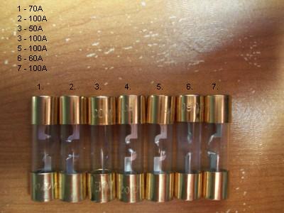

New member Username: FosgatemonsterzSan Lorenzo, California USA Post Number: 5 Registered: Nov-04 | Here is a picture I just took of the 7 blown fuses. I have posed the numbers and how much A's there are in the picture.![]() |
