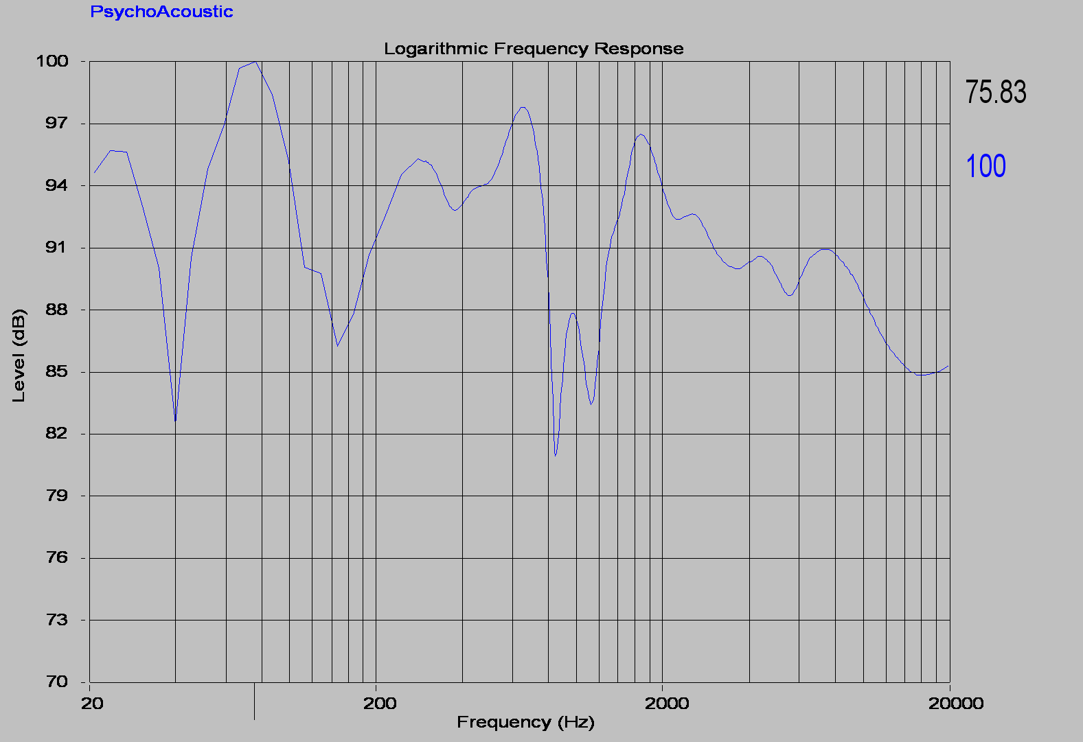

Psycho-acoustical response curve
This is a highly debated subject, and some might say controversial subject, but in our tests it has proven extremely useful. Some acousticians will say that the steady state response is all that you need and for trained acousticians, who may deal with this on a regular basis, this may well be the case. The basic premise of a psycho acoustical response curve is that it mimics in a 2-D graph what the human ear perceives relative to frequency response. Thus if there is a resonant mode it will be displayed as a peak at that frequency. The human ear has longer integration times at lower frequencies than at higher frequencies. Thus the gate time for the psycho-acoustical response curve is longer for low frequencies than high frequencies. Here is a psycho-acoustical response curve of the waterfall plot seen above.
psychoacoustic
We use the psycho-acoustical response curve to set up the PARC. It is very easy to interpret and our results have worked out incredibly well by simply using the psycho-acoustical as our benchmark and bringing it's response as close to flat as is possible.
