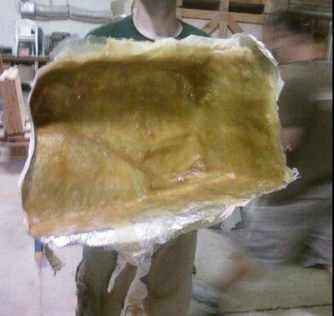

A friend of mine got a ID10 for his RSX and he didn't want a big MDF enclosure in his trunk so we decided to learn how to fiberglass . I had never touched the stuff in my life before then and neither had he. We looked up some info online. This is the guide we vaguely followed: http://forums.clubrsx.com/showthread.php?t=449041
Anyway it turned out to be a pretty fun little project. Unfortunately we ended up making the box WAY too big and we went back recently to seal up half the box by filling it will "great stuff" and doing a couple of layers of glass over it.
Heres some pix of our project:
(sorry I couldn't find some better ones, but u get the jist from these)
Not too shabby for 3 dudes that have never used fiberglass in their lives)
As for materials, id suggest not using plastic cups to mix the resin and hardener like we did, it actually ate though the cups so each time we mixed a batch we were laying strips at light speed, which caused us to look over some bubbles.
For pods a single gallon from home depot should be more than enough
