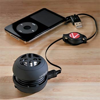

this is jack from china,we are special R&D the mini speaker.it is can use for the ipod,mobile phone,mp3/4 and so on ,pls contact me :jack.zeng66@gmail.comUpload}

Stay away from Jack Zeng@gmail. That little device will keep you occupied and engaged in listening to you music for about 1 minute; mostly because you'll be wondering how that ring-tone quality of sound can come out of something that looks like Darth Vader's Yo-Yo. LOL!

LOL.....
1.3 billion people in China. I got 50 bucks says not one of em is really named "Jack".
But the Yo-Yo looks nice, anyway.

A yo-you that doubled as a MP3 player I might pay for...say $5. But now that I've mentioned Darth Vader, Jack's gonna have George Lucas after him for royalties. Jack Zeng...are you afraid...no...you will be, you will be.

FuckingIPODbullshit. Jack, that thing looks like the biggest piece of crap I have ever seen come out of china. And pretty much everything coming out of china is crap. That says a lot.lol. Way to post an I Pod ad in a forum where people actually like to listen to their music in a proper environment.

You know it is a bot post, right?
