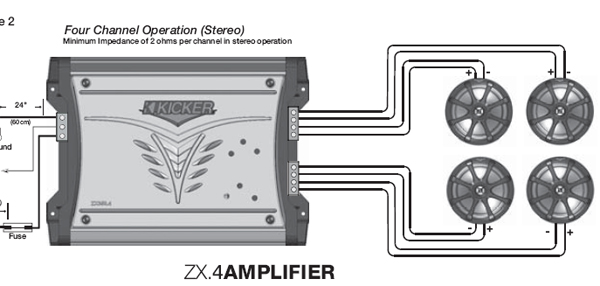

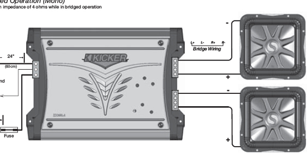

This is so simple man, I think you're thinking too hard about it. The second diagram that Bern posted explains it crystal clear.

"This is so simple man, I think you're thinking too hard about it. The second diagram that Bern posted explains it crystal clear. "
Think of the subwoofers in diagram #2 as the input terminals on your passive crossovers.

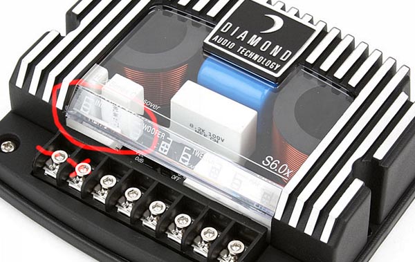

I would need 2 RCA jacks then wouldnt I? like I couldnt bridge one RCA jack? also going from the amp to the crossover, can you place the wire in any one of the 2 input jacks? because there is no + or - on the crossover.

"because there is no + or - on the crossover."
Look at the plastic see through cover......If that does help you, the very left input terminal is -, next to that will be the + input terminal.
IF that doesn't help you I provided a picture for you.
