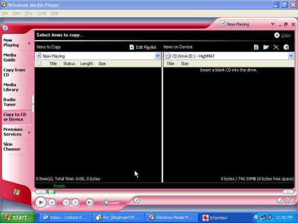

Have a pic of the pre-amp and the software needed for dubbing LPs onto a CD....
Found (after buying pre-amp) that I need a new cartridge....goin' to Wally World to pick up a low-end model....
