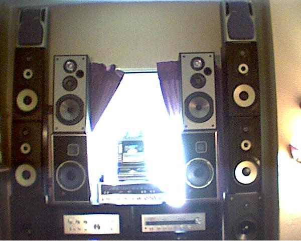

Username: Tdbdrummer
Post Number: 414
Registered: Feb-05
Lol, who liks my "play around" home stereo? I included a picture of the MTX speakers, as they can not be seen in the full view pics.Upload
