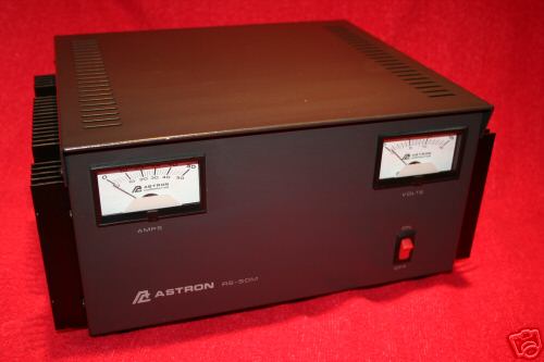

Unregistered guest | Why mess with trying to use a PC power supply? Won't a standard 13.8VDC, 20 amp power supply, used for test benches and ham radios, etc work? I've seen a number of them for sale on eBay for less than $30. 20amps should be sufficient for at least 250 watts, shouldn't it? |
